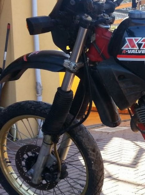

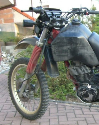

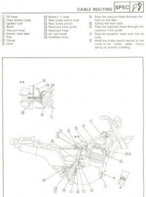

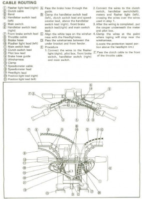

I dont have a 43F but other XT600 models should be pretty similar.
43F pictures:
XT600E schematics:
