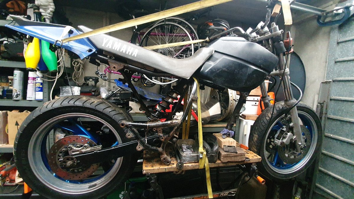

My plan is to see if I can convert this, which is a running project at the moment
Into something similar to this as I never ride off road. This bike was for sale on Ebay a few years back.
Using this which I have just bought. Using the complete front end and rear wheel.
Apparently it should go together OK. I have a bare 3TB frame that I will test assemble the parts on.
Cheers
Min

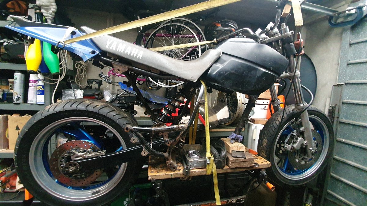

Bigger photos !!
Cheers
Min

TDM front end is a straight swap.
Cheers
Min

Rear went in OK. Just need to make up a wee spacer.

The XT600 spacers and the brake hanger aren't quite correct. Using the XT600 caliper and brake hanger so will possibly have a disc manufactured as the TDM is of larger diameter. But that plan may change.

I would try the spacer if possible. The break disk is a wear part and easier to replace when it's not custom. The spacer lives forever.

I bought a FZ600 rear disc. 220mm with correct bolt spacing. Now I need to use countersunk screes and mill my caliper a few mm.
